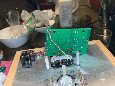

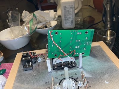

Offline last lemming
    • Posts: 35
Reply #2 on: February 22, 2021, 03:29:22 PM
this is where I am so far
Online Paul Birkeland
    • Posts: 20250
Reply #3 on: February 22, 2021, 03:38:25 PM
Those are teeny, is there any way to get something a bit bigger?

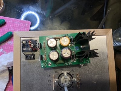

    • Posts: 35
Reply #4 on: February 22, 2021, 03:56:05 PM
hope these are better
    • Posts: 20250
Reply #5 on: February 22, 2021, 04:22:34 PM
Can you confirm that there's a 1085 regulator on the PC board and not an MJE5731A?
You could certainly reheat all your solder joints, but they don't look like I would expect them to in order to end up with no regulation.

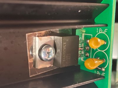

    • Posts: 20250
Reply #13 on: February 22, 2021, 07:59:50 PM
Can you post a photo or two looking at the 1085 and what you're seeing?
    • Posts: 35
Reply #14 on: February 23, 2021, 01:57:33 AM
here you go
