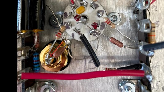

https://photos.app.goo.gl/qdujsXFnAFRwzwn47

I would recommend getting a proper pair of side cutters (I use the CHP-170) and trim off all those leads nice and short that are poking out.  The one coming out of 26L that's almost touching the chassis will smoke part of the amp when it does touch the chassis.
I would reheat the solder joints on the ground lug of each input RCA jack.  Those don't look like they have flowed out all the way.
    • Posts: 9769
Reply #6 on: February 26, 2021, 07:31:31 AM
Yeah and maybe reflow terminal 22. Can't see it in the pics, but that is what the ground end of the output RCA connects to. RE the side cutters, I just got a pile of grievance for not buying $40 swiss side cutters when I posted my intended-to-be-humorous broken sidecutter on social media. A Swiss sidecutter that, I will note, won't fit into a lot of tight places we need side cutters to fit. I would guess the guys posting the spendy cutters don't work in an environment where the less experienced employee will use a soldering iron for a prybar or a ceramic screwdriver as a cold chisel. I lost a really nice $500 solder station to that kind of activity. The $5 side cutters like Hakko and Xcelite we have around are perfectly adequate for what we are doing and it's no biggie if somebody does something dumb with them. We cut thousands of pieces of wire with those cutters every year.

https://photos.app.goo.gl/EcjzRKeadbBoaBdS9
Here is a new set of pictures focusing on the black RCA side
