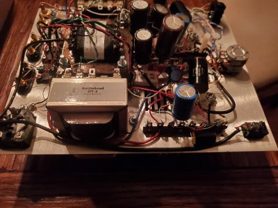

Offline Gobes
    • Posts: 22
Reply #13 on: March 03, 2021, 12:55:01 PM

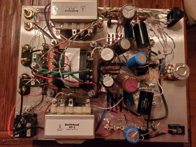

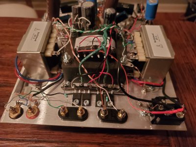

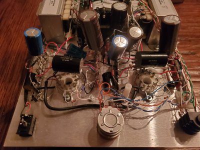

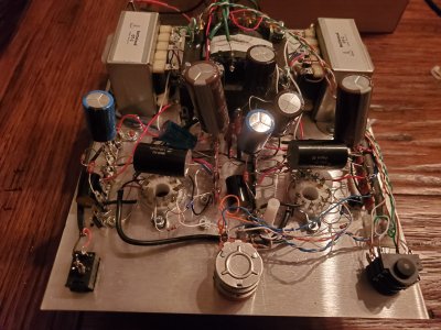

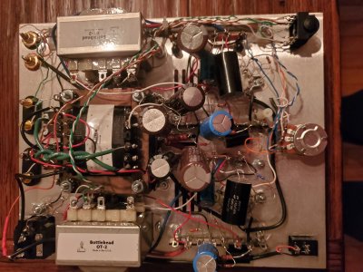

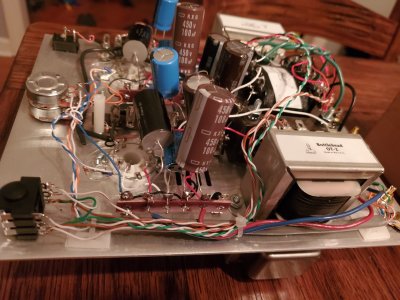

Thank you Doc and Paul. I appreciate your input. As mentioned before you guys are the experts and respect that. The reason I bring this issue up as just a week ago, the clarity was fantastic. Suddenly, something changed. I have taken some additional pictures.  As mentioned I love the amp, but it's just different from last week. May be something I might have missed. I have attached futher picks for your references. Thanks again and I respect your time in helping me solve this issue.
Offline Gobes
    • Posts: 22
Reply #14 on: March 03, 2021, 12:56:20 PM
More pics
