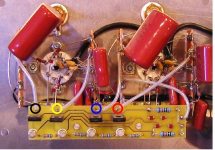

These are the points where you want to measure DC voltage.

Measured:
42  Black  61V
37  Yellow  66V
32  Blue  65V
27  Red  70V
  • Posts: 18155
Re: Help with Seduction with C4S
« Reply #6 on: March 06, 2021, 10:48:34 AM »
Those are working voltages.  You likely do have a loose connection.
