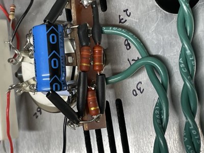

Reply #2 on: March 07, 2021, 06:28:38 AM
Here's the resistor bundle on the bad channel:
    • Posts: 20295
Reply #3 on: March 07, 2021, 06:30:41 AM
30U looks like it might need a more solid crimp and some solder reflow.

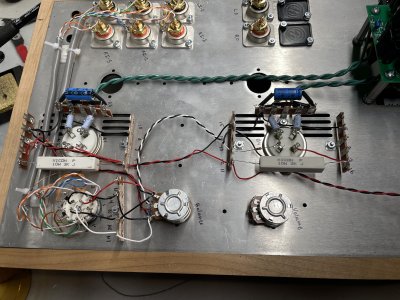

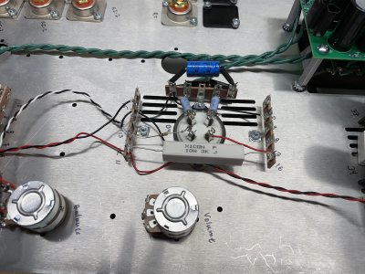

Reply #8 on: March 07, 2021, 07:30:24 AM
A random selection.  Happy to send more.   Thanks for bearing with me.
— Gideon

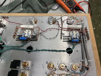

    • Posts: 20295
Reply #9 on: March 07, 2021, 09:18:15 AM
You can use more solder on the joints on the terminal strips.  The terminal strips are phenolic and metal, and the teflon coating on the wires won't melt from your soldering iron, so don't be afraid to leave your iron on each joint for 10+ seconds, as there isn't really anything that's going to be damaged by doing that.  I suspect if you add more solder and reflow your joints that those problematic voltages are going to move around a bit.

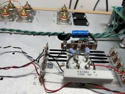

    • Posts: 20295
Reply #11 on: March 07, 2021, 12:02:40 PM
Does that localize the problem to the capacitor terminals (26U and 30U)?
You are certainly welcome to remove the capacitor from those terminals to see if that does anything.  Looking at your photo, the lower joint below where the banded end of that capacitor connects has not had adequate heat applied to it to flow out properly.
