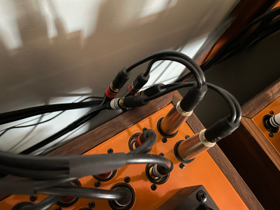

Here's a shot of the RCA cables at the BeePre end if that helps

I'd expect that if I unplugged an input but not an output. Is that typical behavior or is that symptomatic of a problem?
The unplugged cable becomes a big antenna that can pick up noise and present that at the inputs of your amplifiers.

Reply #5 on: March 10, 2021, 09:51:00 AM
Thanks, PB. It's a pretty long run of cable, too, so that tracks.
Mostly wanted to make sure I wasn't operating with some problem that would blow up into a much bigger problem later.
