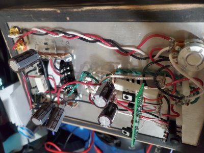

So i have Crack 1.1 in full functional condition, then i went for Speedball upgrade . So the problem is one of the red led lights not turning on (D1 B side ) when i do a test after soldering first board to the amp . All voltages and resistance are ok and are same as in the instructions. Not sure what is wrong cause i made absolutely sure all solder points are good . Anyone know what's going on ? Thx

Can you post the voltages you have on terminals 1-10?

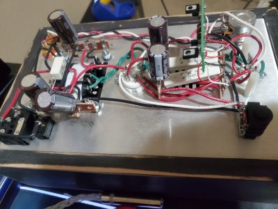

How about also posting some build photos?

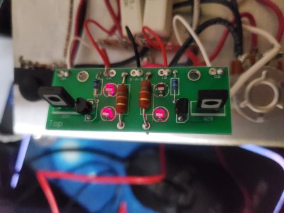

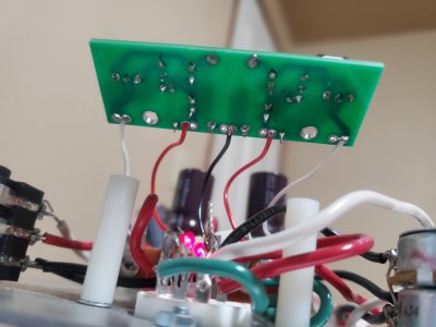

So the smaller PC board?  Can you post a couple of photos of the board (top and bottom)?

The Speedball upgrade comes with two green PC boards with white text.  The stock Crack has no PC boards.  One is small and sits over the 9 pin 12AU7 socket and one is larger and sits just forward of the octal 6080 tube socket.
You have said you have a D1 LED out, but there are four D1 LEDs out.  Which board is it on?  Can you post photos of the top and bottom of the PC board with the LED that's not lighting up?

Reply #10 on: April 26, 2021, 07:07:49 PM
Here

You have a backwards transistor on your PC board.

Reply #13 on: April 30, 2021, 08:50:59 AM
Which one ?
Offline stanmar224
    • Posts: 11
Reply #14 on: April 30, 2021, 08:58:28 AM
Oooh wait i see it . Its that little black one . OMG im so stupid.
