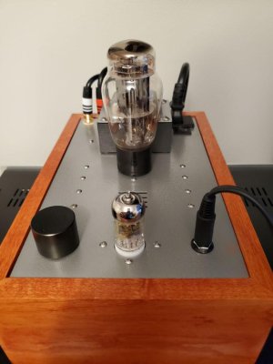

The hum seems to come from EMI or RFI between the input and output tubes. If I put my hand between the tubes, the hum goes away. I can make it worse if I route the AC power cord between the tubes as you might expect, but keeping all other sources of interference out of the way doesn't help. Shutting off all other electrical devices in the room doesn't seem to help.
Some tubes combos are quite noisy (a new Genalex Gold Lion 12AU7 causes loud hum with a 5998 and a 6AS7G), while some tube combos are much more faint (JJ ECC802S is barely audible with 5998 and 6AS7G), but all of my tube stash has the noise to some degree. I am beginning to suspect this hum has always been there, but I only noticed it when it was really loud with the new Gold Lion tube.

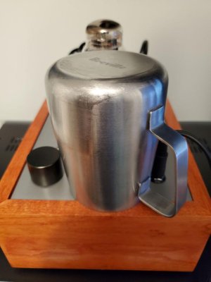

A tube shield might be in order here  :^)  Plop an empty tin can over the ECC82 and see if that helps?
Empty! Of course! That explains why my last amp ended up filled with tomato soup.
I actually had no cans available, but tried with a stainless steel milk frothing jug. And sure enough, covering the input tube immediately and completely cut the noise (even more effective than 'meat'). Covering the power tube did nothing. Considering stainless steel is non magnetic, I think we can definitely confirm some kind of radio interference to the input tube.

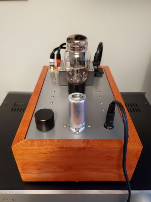

Shield received and installed, and it cleared up my problem 100% - my Crack is now practically dead silent across the entire volume range. The shield looks pretty dapper to boot, although I will probably spray paint it in hammered finish to match the rest of the amp.
I'm still unclear as to whether there was an underlying issue that made this hum/buzz come to the fore, but for now I'm going to go with 'no'. I think I just have an RFI issue in my amp's location, that was highlighted by a particularly sensitive tube.
