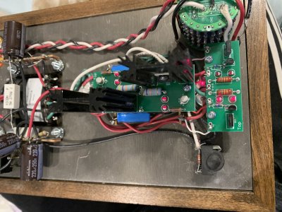

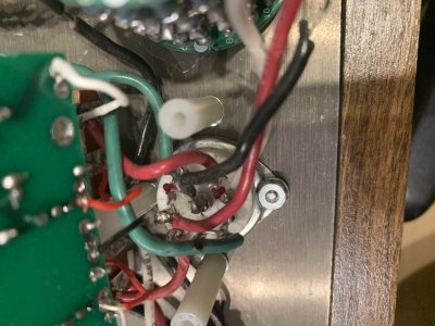

Assuming that the above problem is fixable, I did have some pictures of the LEDs before I screwed it up with the solder.

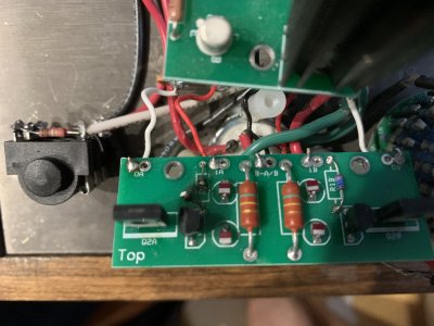

The 2 LEDs by the 9-pin socket were lit, and the 4 LEDs on the big circuit board were lit, but fairly dim in comparison to the 2 LEDs on the small circuit board. And as you can see by the image, the other 2 LEDs on the small circuit board don't light up.
In terms of voltage for the small board (before solder screw up), OA and OB were both at like 375 volts, so that's why I tried resoldering A7 (voltage was about 2 volts) but not A2 (voltage was 0). After putting a bunch of solder it's still at 375 volts. I'm definitely removing the excess, but I'm curious (assuming that removing it works) as to why too much would cause such an issue.
This tells me that your stock Crack build didn't work properly.  Are both black wires at the headphone jack captured by solder?
Can you list the voltages for:
Small board OA, OB, IB, IA.
Big board OA, OB.
I would need to see a picture of what's hooked up on your 9 pin socket, since you seem to indicate that maybe you only have one LED there.

It appears that one led on the A socket is miswired. It should be connected between pin A3 and the center terminal. It seems to look like it is connected to pin A1 and pin A2 or A3, It is hard to tell because the wiring is obscuring the connections.

Yeah sorry for the bad photo. It was mostly just to show that I had both of them there, but the angle is definitely pretty bad. One LED is going from A3 to center, and the other LED is going from A8 to center.

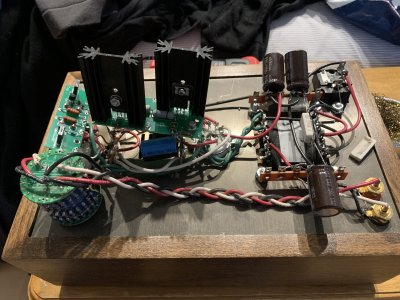

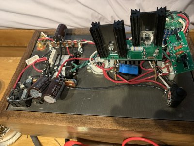

Ok so after reflowing/adding solder to some of my joints, somewhere around the transformer (probably one of the huge resistors) started smoking. I tried reflowing/adding solder to other joints again to try to get rid of the smoking, and this time for some reason R1A on the small board basically burned up (mini fire lol).
Now I'm not sure what to do.
Any idea on how soon the repair service will be available? I'm getting pretty frustrated at this point and would just like to get it to work.
« Last Edit: May 19, 2021, 08:06:00 PM by pickles3201 »
    • Posts: 20297
Reply #8 on: May 20, 2021, 05:21:56 AM
You can contact queen(at)bottlehead(dot)com and she can set you up with a repair service provided all the parts you've used to build it are parts that came from us.  If there are sockets, caps, resistors, pots, etc. that are aftermarket parts, you'll need to take those out first and install the stock parts.  Be sure to provide a link to this thread when asking for the repair service since we are no longer offering repair services without at least an attempt at getting help here first.
The 151V at terminal 1 would have had me asking if both LEDs on your 9 pin socket were working and if they weren't there would have been further checks. The smoking power supply resistor tends to indicate that there's a problem with the large Speedball board since the 9 pin socket and associated parts can't draw enough current to heat up those power supply resistors very much.

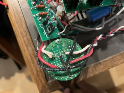

Can you post a photo of the build?  If you have something like an Alps Blue wired in without a PC board supporting the pins, that will have to come out during the repair process and be replaced by the stock pot, and I would be relatively certain that pins will snap off and the pot will no longer be usable.  In fact a snapped off pin on a pot could cause the problems you're having...
Offline pickles3201
    • Posts: 14
Reply #11 on: May 23, 2021, 03:05:02 PM
No I just have a stepped attenuator that I bought but it has like "cups" which I guess you fill with solder and put the wire in.
I will say that I did some very jank things, like soldering a ground wire to another black wire to extend it so it could reach the attenuator's ground terminals.

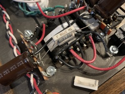

I know that the wiring is not great and everything is really messy, but unfortunately I was pretty young and eager to finish it so I guess I forgot about neatness. I also included a picture of the burnt speedball resistor and one of the ceramic-covered resistors that ended up cracking later.
