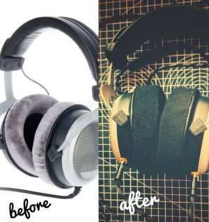

Now to disadvantages... THAT CABLE. DT880 cable is absolutely awful long rubber snake and even their jack plug is poor quality. I spent 1 day reflowing every joint in Crack like madman, only to discover that DT880 1/4 in 1/8 in adapter is misaligned and broken, causing headphones to work as 1200 Ohm mono, two channels in sequence.
I ended up modding them to have a detachable cable, could not be happier now
https://forum.hifiguides.com/t/beyerdynamic-dt880-600ohm-balance-mod/13150
