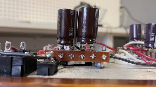

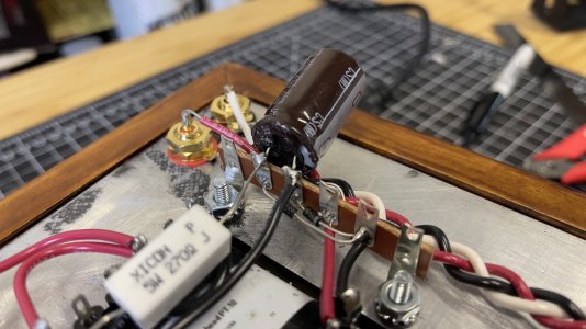

Build just finished, resistance check went off without a hitch, but voltage check had one and only problem, Terminal 9 showed 140V. Turning off the amp produces a loud buzz in the right channel, no sound in the left channel, and this is with/without RCA cables. Posted some pictures, any help is appreciated!

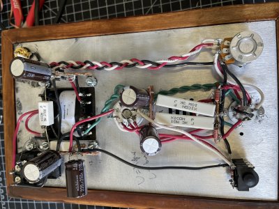

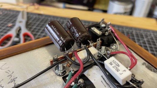

I see some very long leads on one of the 220uF power supply capacitors.  It also doesn't look well soldered.
You have no wire connected to B4.  You have two wires connected to B3.  This is not correct.

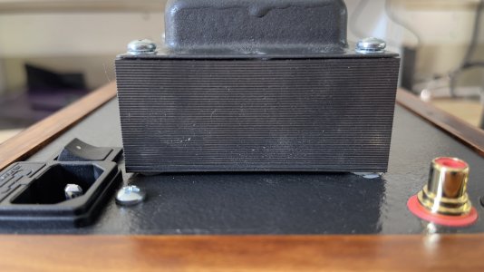

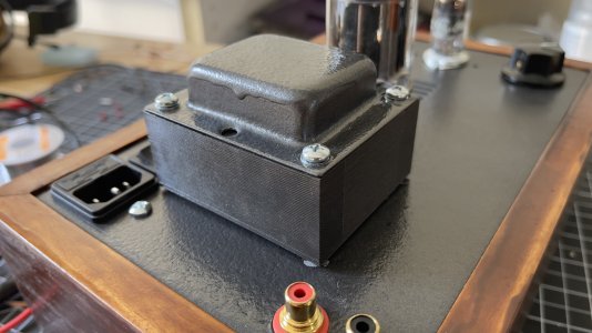

Re-wired B3 and B4, and tidied up the capacitors. Resistance and Voltage checks passed, nothing over the limits now. Got both tubes glowing. Now I get still get a decent buzz in both channels, both with and without RCA cables. When building the kit, I never received #8 star lockwashers to go between the transformer cap and the transformer itself. The locknuts with teeth are properly tightened, per instructions. And of course, during this process, I managed to mangle the LEDs completely. Re-did the resistance and voltage checks and everything was within limits once again. If I take out the 12AU7 vacuum tube, the buzzing stops.

If you pull the 12AU7 out of the amp while it's running, that's just not OK on many levels.  You may do some serious damage to the 6080 or the amp itself by doing that.

This would suggest a loose 220uF capacitor, possibly a different loose connection, or just loose hardware in general.  The lack of #8 star washers shouldn't cause major issues.

Reflowed and trimmed as much of excess leads as I could, not seeing any gaps in the joints from my end but the problem still remains. Buzzing in both channels regardless of volume or RCA inputs

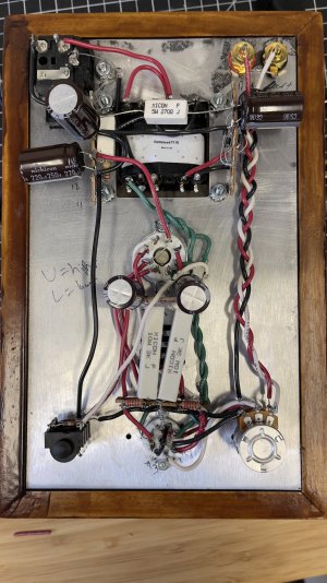

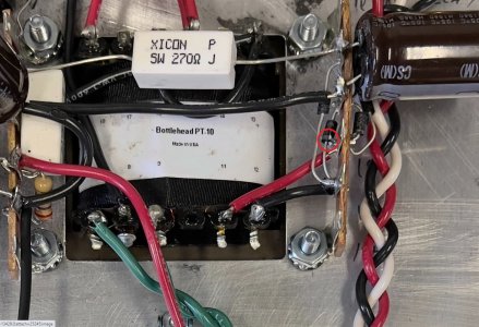

Can I see an overall shot of the top and bottom?

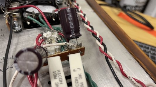

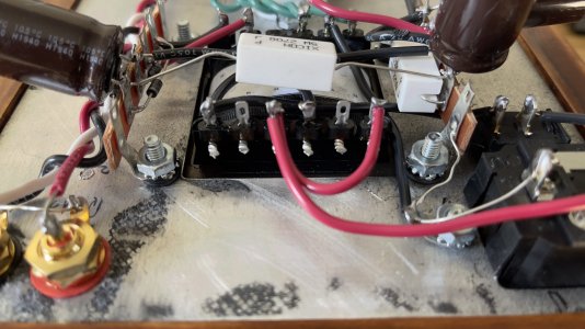

Reply #12 on: June 22, 2021, 04:23:59 PM

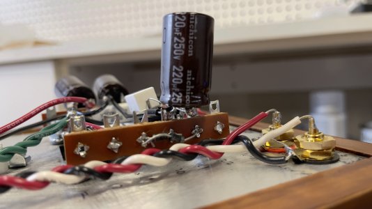

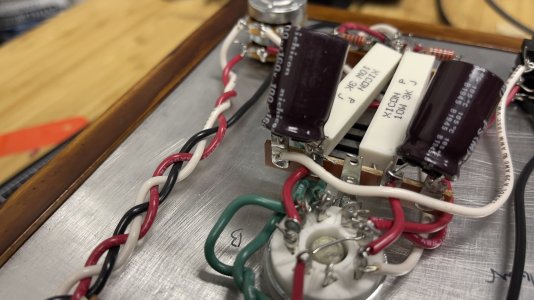

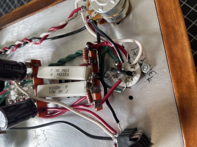

Here ya go, let me know if you need me to take more of particular components
    • Posts: 20299
Reply #13 on: June 22, 2021, 05:17:29 PM
If these touch, you will run into some bad issues, but this isn't going to cause buzz.
    • Posts: 20299
Reply #14 on: June 22, 2021, 05:22:09 PM
3U does not look to be soldered and the leads need to be trimmed back.
A9 does not look well soldered.
The wire going into A4/A5 has too much jacket stripped off.

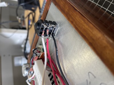

I would definitely want to see the wiring of the headphone jack.
