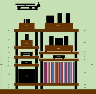

Looking to make the leap into Kaiju and BeePre but need to redesign my hifi rack.
I have space to extend upward but not sideways which means one of either BeePre or Kaiju will need to go on a lower shelf.
Natural inclination is to have Kaiju below with BeePre on top shelf.
How much clearance above the Kaiju is needed?
I understand tubes will generate some heat.  Will have good ventilation at rear and sides.
Shelves are solid 40mm walnut. OK to get hot but don't want it to get scorched.
Legs will be made to order and am currently allowing 290mm (11.42") total clearance which should give just under 2" clearance.
Is this enough and if not, how much should be allowed?
Thank you in advance for any suggestions or advice.

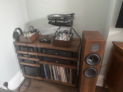

Pics are of current setup and redesigned layout.  Can't wait!

If the TTPSU can tuck between the Eros and the BeePre you can drop the Kaiju down 105. That should help. Having the PSU closer to the TT is no bad thing.

I have about 7 different layouts so far including ones where I lose a shelf.
That's the favourite at the moment and minimises number of new legs to buy.
I should have added, manufacturer recommends max 300mm (12"), or bolted legs for anything longer.  This may entail a new shelf.
Manufacturer probably being cautious but better safe than sorry!
If Kaiju is too hot on lower shelf I can swap with BeePre (which I am told is less of an issue).
Main concern is getting some distance between Eros and components that might cause noise.
