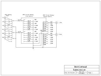

Hi,
Anticipating the arrival of my Mainline - tracking shows it in country !!   :D
Is it possible to have a copy of the schematic for the Mainline attenuator please?  The schematic in the manual just shows a variable resistor labelled "Submissive Attenuator".
I like to have schematics to refer to as I build, to avoid mistakes.
Paul.

Here is the schematic from the Submissive, which though discontinued used the same attenuator configuration.

Thank you Paul - much appreciated.
