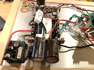

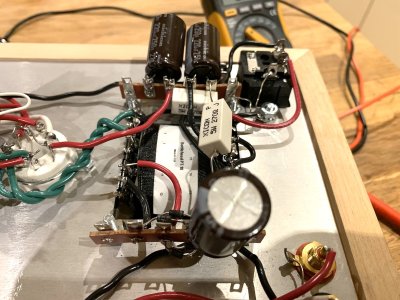

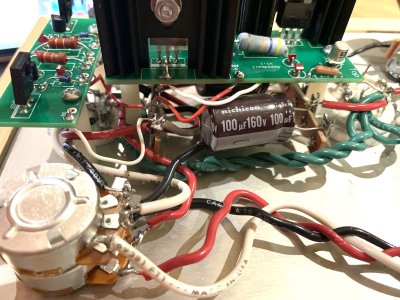

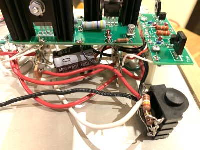

Here are some photos. Not sure if I’ve taken them of the right things but I can retake some if I haven’t. I feel compelled to apologise for the messy soldering, even though it’s not mine :)
« Last Edit: October 05, 2021, 01:44:06 AM by RankStranger »

The pot wiring looks to be reversed compared to my standard crack but I don't think that affects voltages.

In the beginning of the Crack build manual, there are instructions for how to attach and solder wires and components to terminals in the Crack.  These instructions were not followed.
Every joint in that amp needs the solder sucked off of it, the wires need to be crimped to their attachment points, then they need to be resoldered.
Without doing this, reliability problems are likely to continue popping up.
