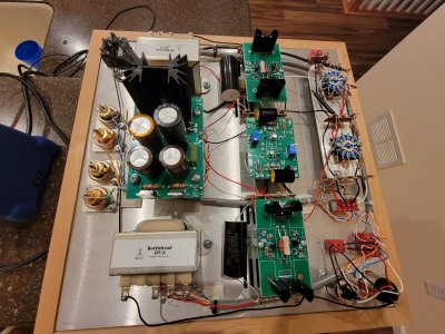

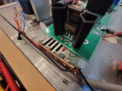

All resistance checks are find except for terminal 12 and 14. They are both reading absolute zero. Wrong wiring to the c4s board?

12 and 14 have no connections.  Is your meter showing zero or "OL"?

Usually my meter will read 00.1ohm for those indicated to read zero.  In the instructions 12 and 14 are starred, so I assume should have some value?
I'm getting no reading on 12 and 14.  If I touch red probe to the top plate I read 00.1ohm 12 and 14 do not change the meter reading from the default 0.L
    • Posts: 20281
Reply #3 on: October 28, 2021, 06:57:34 AM
"OL" means "Over Limit", which is the opposite of zero.
Offline RestoredSparda
    • Posts: 84
Reply #4 on: October 28, 2021, 07:00:54 AM
My apologies. Still learning (clearly)!  Is this an issue, or safe to proceed?
« Last Edit: October 28, 2021, 07:03:27 AM by RestoredSparda »
    • Posts: 20281
Reply #5 on: October 28, 2021, 07:09:16 AM
It's safe to proceed.
