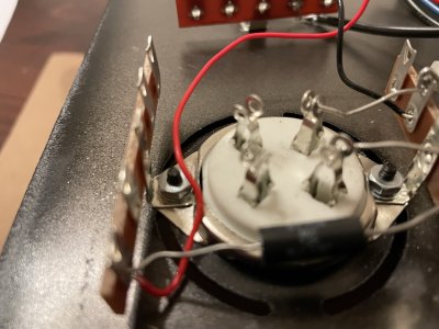

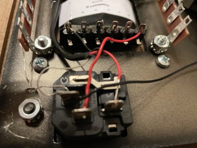

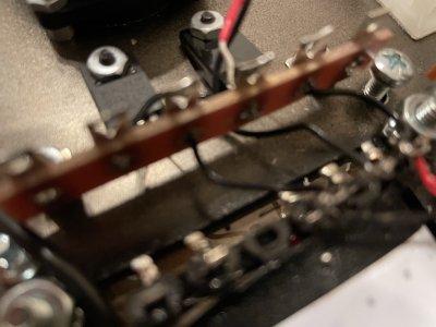

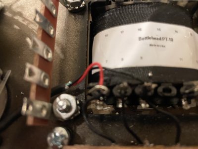

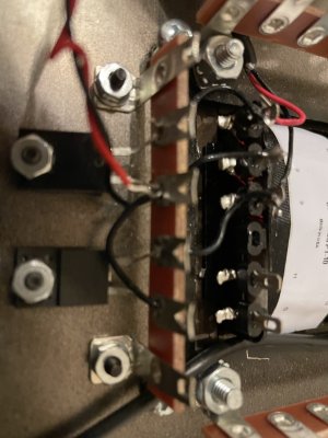

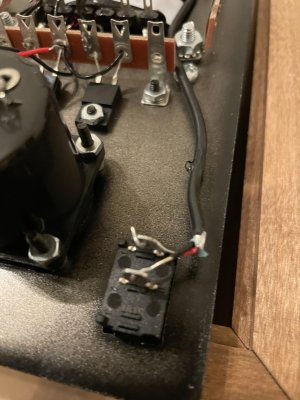

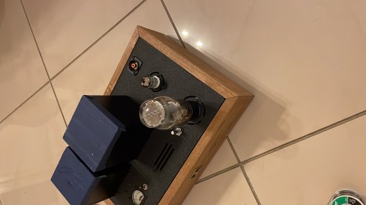

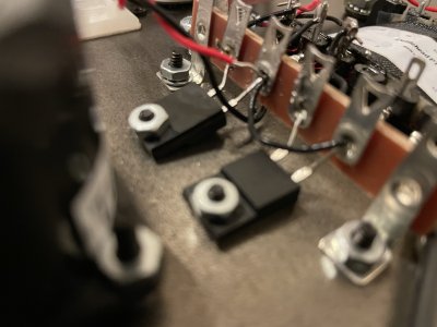

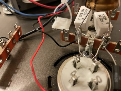

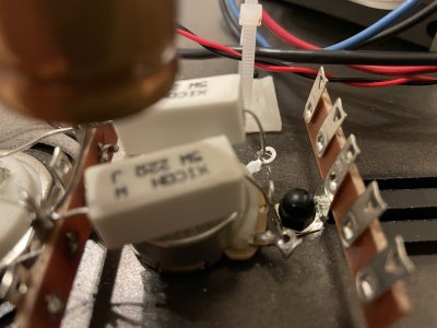

Of course. Here you go. It's probably something as stupid as "have you checked that the printer is actually plugged in" or "you've wired the wrong plug"...
Many thanks for the help.
    • Posts: 20283
Reply #3 on: January 05, 2022, 09:07:52 AM
You need more solder and a lot more heat to get good joints.
If the MBRF diodes are not mounted flat against the chassis, they will overheat and blow.  I see at least one of them is mounted at an angle and that will absolutely lead to a failure.
If you take photos from maybe an extra foot away, your camera should be able to capture more objects in focus.
The black jumper on your power transformer looks to not be soldered on one end.

A couple of updates, which might mean very bad news for me. First, the diode that wasn't flat against the chassis was actually mounted upside down. I know, awfully stupid. I hope I didn't destroy everything by doing that. Anyhow, I've now turned it the right way up.

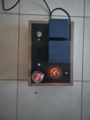

If you put your meter probes on terminals 1 and 4 on the 4 pin socket, what DC voltage do you measure?
Offline Suger
    • Posts: 54
Reply #7 on: February 05, 2022, 08:19:58 AM
DC I get 4V.
    • Posts: 20283
Reply #8 on: February 05, 2022, 09:21:57 AM
How about with at 2A3 in the socket?
Offline Suger
    • Posts: 54
Reply #9 on: February 05, 2022, 04:17:42 PM
2.4V
    • Posts: 20283
Reply #10 on: February 05, 2022, 04:20:35 PM
Those two data points tell me the 2A3 is glowing.  It's not a very bright glow, so you may need to turn the lights down a bit to see it.
Offline Suger
    • Posts: 54
Reply #11 on: February 06, 2022, 03:10:24 AM
It is glowing indeed. Faintly, and I thought it was the relfection of the red writing on the lamp, but it's glowing.
Many thanks for your patience.
P.S.: much better after nightfall!
