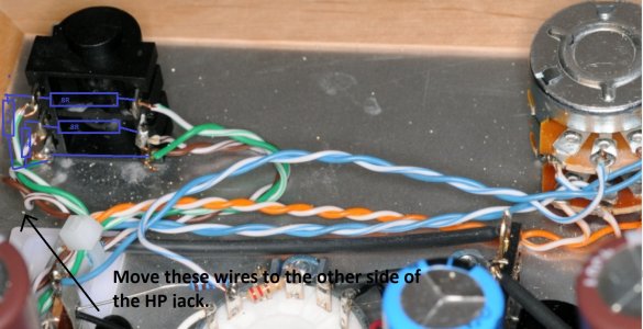

You'll want a pair of 8 ohm resistors that are 2-3W rated parts and a pair of 2 ohm resistors that 1/8W or so.  Move the Cat5 wires that connect to the outside lugs of the headphone jack to the inside lugs with the other cat 5 wires.  Attach one 8 ohm resistor between the upper pair of jack lugs, another 8 ohm resistor between the middle pair of jack lugs, and a piece of wire across the bottom pair of jack lugs.
You can also try to the recipe above adding the 2 ohm resistors between the upper outer jack lug and the lower outer jack lug, as well as the middle outer jack lug and the lower outer jack lug.  This will likely be preferable to just the 8 ohm resistors on their own.

I soldered in the 8 ohm and 2 ohm resistors tonight and fired it up with the grados and shorted rca inputs. Silence. So silent I thought I might have made a mistake... But no! With music on, wow. Wow. Wow.
Thanks so much Paul!
