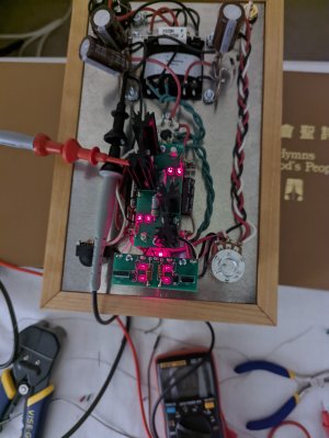

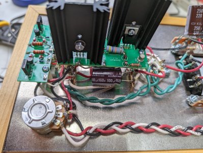

Got the Crack working but ran into issues while assembling the Speedball specifically high voltages on the Big Board and Small Board's OA and OB.  Both tubes and LEDs all lit up, using all stock parts, photos attached.  Any suggestions?

Was the small board working OK at the first check in the manual?  I see a lot of flux on your 9 pin socket and kind of all over everything, which exact product did you use?

I recall the small board OA/OB voltages were about 94-99v which was within the 10% margin before assembling the big board.  I used a 60/40 rosin core solder and RA type/non-corrosive flux.  Will check for the LEDs on the 9 pin socket but attached a photo of the top side leds.  The 12AU7 has been used for less than an hour and the flux still need a bit of cleaning.
