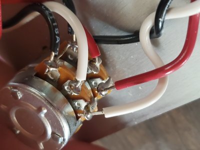

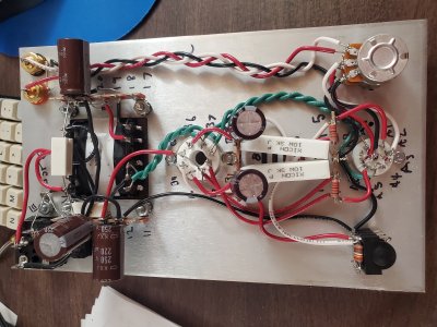

I built my crack a while ago and have been using it but have noticed some issues.
The biggest one I've noticed so far is that the volume is unbalanced at low levels.  If you imagine the volume control to go from say 7 o'clock through 12 o'clock to 5 o'clock, then between 830 and 5 it's totally fine - but between 7 and 830 the right channel comes through nicely (and quietly) but the left channel is nearly silent.  Once you pass about the 830 point the left channel comes to life at the same volume as the right channel (i.e. it jumps from very quiet to the same level as the right channel).
Has anyone experienced this before?
I attached some photos just in case they help.  Please let me know if you see anything else that needs attention - I've noticed some squeaky Styrofoam-on-Styrofoam like noises intermittently but haven't tried to debug that yet either.

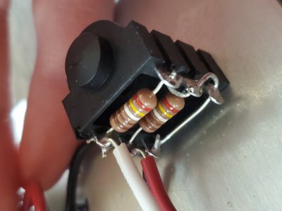

I finally got around to adding the dropping resistors to the potentiometer.

Terminal 13 connects to B5.  B5 connects to B2.  B2 connects to terminal 2.  Terminal 2 connects to terminal 4.
Your terminal 13 isn't making it to terminal 2.
    • Posts: 19587
Reply #11 on: March 08, 2022, 05:38:47 PM
Looking at your build photo, when the instructions say to "attach" something, that means making a mechanical connection by bending the wire or component lead up and around the terminal.  In your build, things are cut and slid through holes and terminals, then just soldered.  By doing this, you will allow for the wires to slide out of the solder and come loose, and that is probably what has happened.  You can go back through and just bend each little end up 90 degrees against the terminal it's connected to, then add some more heat and solder and that will help a lot.

Gosh darn you are good - you were right on the money - 13 -> b5 came loose.  Funny enough it's the only cable in that chain that I did bend around the terminal - I must have just dropped the ball.
I'll reattach it tonight and bend over the other connections and report back.

The dropping resistors on the volume pot helped a bit, it's still very loud even at the bottom of the potentiometer but it's more balanced which helps greatly.  Tomorrow I'll scrub the pins on the tubes and see about decreasing my Styrofoam problems.
