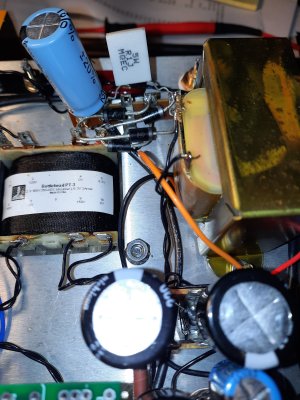

I got a chance to get a couple of pictures. I have no voltage from tube sockets #7 to #8

Paul Birkeland
Global Moderator
20203
Re: SEX 2.0 B+ voltages too high
Reply #11 on:
March 23, 2022, 07:50:21 AM
C2 and C5 connect with a 0.1 ohm resistor. Your voltage measurements show 5.8V on C4 and 0V on C2. IF those two terminals are actually connected by the 0.1 ohm resistor and you have those voltages, the resistor would burn up very quickly, so I suspect that resistor is loose.
Doc B.
Administrator
9755
Reply #12 on:
March 23, 2022, 08:14:11 AM
It sounds most likely to be a bad solder joint. The solder joint at terminal 4 of the power transformer looks a little suspect. I would be inclined to reflow PT terminal 4, C1 and C4. Then recheck the voltages at C1,C2,C4,C5.
Bill S
Jr. Member
18
Reply #13 on:
March 23, 2022, 02:40:22 PM
Fixed! Thanks guys! You are a great help.
It did turn out to be a bad solder joint. It was a bad connection at terminal C1 which is a ground connection. The black jumper wire that comes from C4 had a poor connection at C1. I had reflowed all the connections around that part of the circuit at least once while troubleshooting. This evening I did a much more thorough redoing of the power transformer connections and terminals C2, 4 and 5. After I was done my resistances at C2 and C5 were normal but C4 still had high resistance. C4 connects to the C1 ground connection with a short jumper wire. I used a jumper with alligator clips to connect C1 and C4 and then my resistance at C4 was fine. I then heated and pulled the black jumper wire connection loose from C1, resoldered and everything's fine. The amp sounds awesome again.
