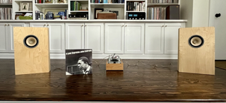

Get your minds out of the gutter! Recently completed an open baffle project with Lii Audio 6.5 in full range drivers and using with the sex 3.0. Holy shit I can’t believe how good my lps sound! Using my main system preamp (restored McIntosh C24) and I just want to sit in front of these speakers all day! Thanks Doc and team for making this kit possible, I am amazed by the sound I am hearing.

Adding a photo helps bring the whole story together!

Nice Karl!
I see you are rocking some OB yourself connected to the Stereomour... I am thinking that might be my next build but not sure. I have to be honest, I have been working in my office this evening after supper and listening to the Lii Audio 6.5 (Fast 6) full rangers in the open baffles I have in the photo in post 1 and am still just blown away with the sound. I am listening to acoustic guitar/singer songwriter tonight and I feel like I am sitting in a venue while I work! While not on par with my analog front end in the main room, the SeX3 with the OB's and a Border Patrol DAC with a dedicated Mac mini as a music server is really putting a big smile on my face while I grade assignments!
