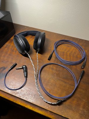

I finally built my first crack+speedball for myself about a month ago. When I had a problem with my resistance check, I came to this forum and found the solution to my problem. When I was experiencing a crackling sound a few weeks after the build, I discovered the chopstick test and was able to identify a couple loose solder joints. I've taken a deep dive into Bottlehead's philosophy on audio. Building the amp myself has been unendingly fulfilling. I even built a modular cable system so that I can listen at my desk or across the room without tripping over 15 feet of cable.

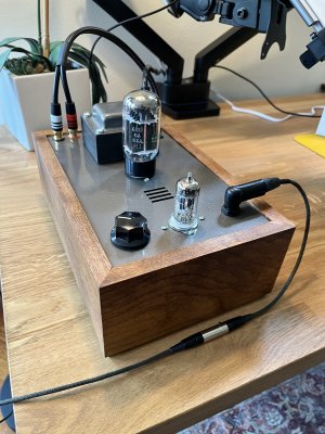

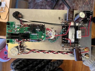

As a bonus, I'm attaching some shots of the build. Thanks all!
