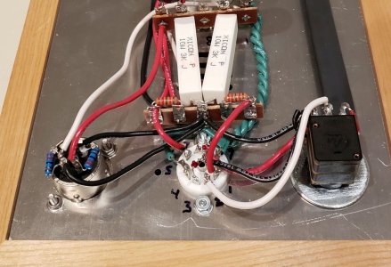

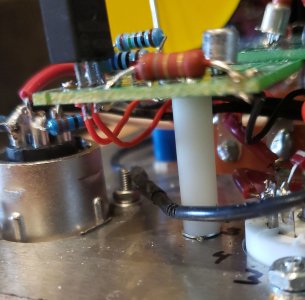

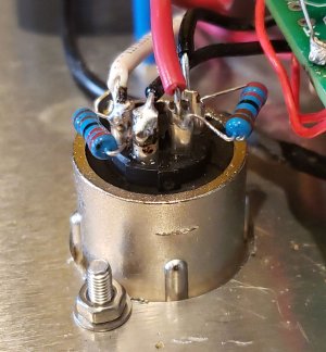

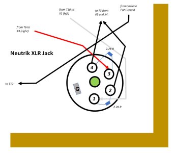

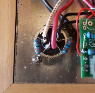

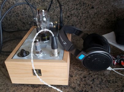

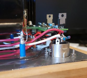

I was able to swap my Neutrik TRS jack with a Neutrik XLR today. All is very well. Bye bye adapter and popping is completely eliminated when plugging and unplugging with volume at zero.
The change was challenging as I needed to do all the work with the old Speedball boards unbolted but still wired. Room was minimum. But, I took my time and told myself not to swear (at myself) like I usually always do. "YOU - DUMB - #$@&" is the goto phrase.
I rerouted the volume pot ground directly to T12 as shown. The XLR ground lug was not used. I needed to add two black wires for pins 2 and 4 that routed back to T3. Lastly, I used 2.2K resistors instead of 2.49K because that is the closest value I had.
It was absolutely worth it for me. Amp is dead quiet. It is so nice to plug the cable directly into the amp and I love XLR connectors. Anyway .....

My Crack was from 2014 and the ground wiring is slightly different but overall similar.
With the new kit you just have to add a single black wire from the XLR jack to T3 since there is already one black wire in between. Pins 2 and 4 need a wire going back to T3.
The black wire from T12 would need to be extended to the volume pot lug with the black wires connected.
The resistor mounting would be similar.
Be aware that there will be limited room to work if you have Speedball and adding a wire to T3 may require some de-soldering.
Also beware that the red and white wire lengths must be long enough to reach pins 1 and 3.
I believe that is all that needs to be done. Anyone can feel free to correct me if there is a better way.
Also, a 15/16 inch hole must be drilled. A stepped drill bit at slow speed cuts good but makes a lot of shavings so you have to think about containing them.

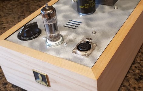

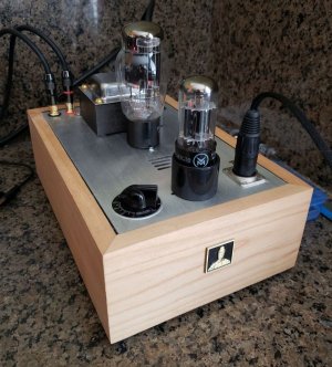

I just finished building a new Crack without Speedball. I installed an XLR jack right from the get go instead of the TRS jack. It was straight forward and went well.
2 black wires from the jack to T3 L and one from 12L to T3 L (other side). ......... 4 wires total go into T3 L when doing this but it is possible with some patience.
Amp is dead quiet and is amazing with no speedball. Either way is going to be an excellent experience.
