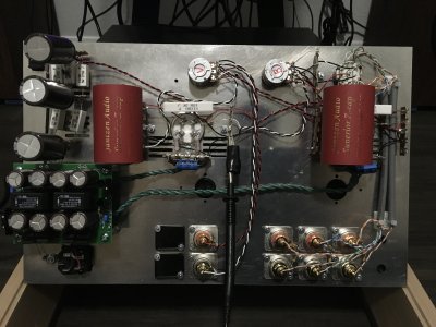

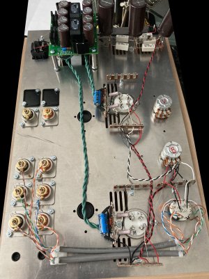

A big thank you! I’ll go back and check the resistors. Here are a couple pics I was going to post. Thought I had the right ones in place.
