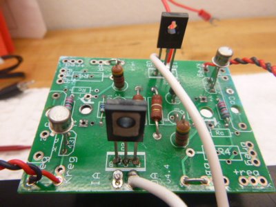

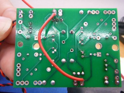

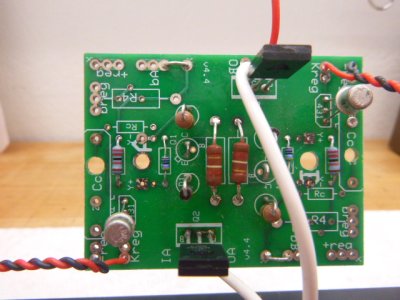

Attached please find two photos of the PJCCS.
    • Posts: 20297
Reply #5 on: May 04, 2022, 10:12:09 AM
From your photos I can't see the bottom of the PC board, the orientation of the UF4007 diodes, nor the rest of the Quickie build.
Since you have one working channel and one dead channel, be sure everything is consistent between sides.  Beyond that you're very likely looking at a loose connection or flaky solder joint, but do keep in mind that this could be in your original build and not the PJCCS board itself.

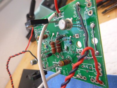

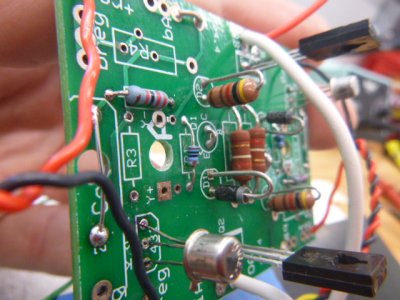

Reply #8 on: May 11, 2022, 10:44:13 AM

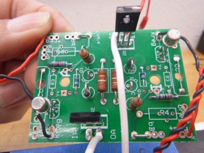

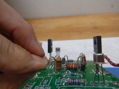

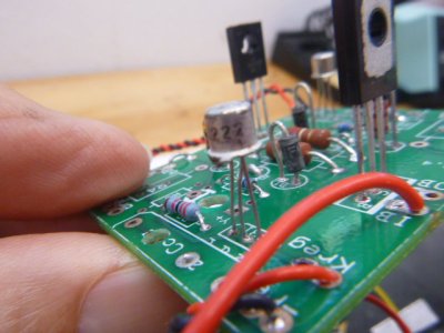

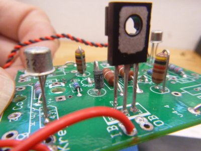

Plese see photos of the attached PJCCS attached.
If you need any additional photos, please let me know.
    • Posts: 20297
Reply #9 on: May 11, 2022, 10:51:21 AM
You must have bought that kit on a pretty early run of the PJCCS.  There was an error in the very original manual that we subsequently corrected.  If you PM me your e-mail address I can send you a copy of the last manual revision that's more up to date and properly shuts the circuit down when powered off.

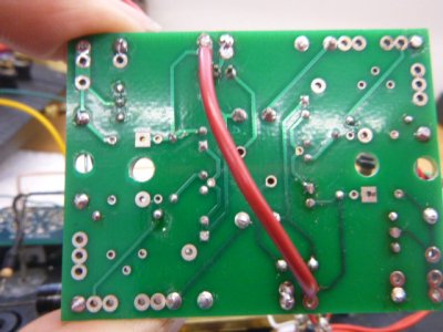

Reply #13 on: May 12, 2022, 10:00:34 AM
Paul,
I made the changes to the PJCCS suggested in the revised manual and now see the following test voltages.
IA 34.9V
IB 34.9V
A6 34.2V
B6 23.8V
A5 2.8V
B5 1.7V
The CCS only conducts when the tube filaments are powered.
Attached please find photos of the revised build.
Any other suggestions are appreciated.
    • Posts: 20297
Reply #14 on: May 12, 2022, 10:02:25 AM
If you flip the board  and connections 180 degrees, does the problematic voltage move to B6?
