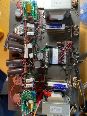

Hi,
I am currently trying to do the driver testing.
IA = 482 volts
OA = 300 volts
However, 46U <--> Safety ground
Gives close to 0 voltages. Trying both sides and same results (i.e. 32U <--> Ground)
Any idea on where I should look? Feels to me like a missing connection.

I see substantial damage to one of your filter caps and a blackened power supply resistor, is there a little more to the story?

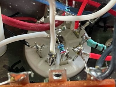

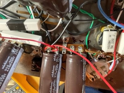

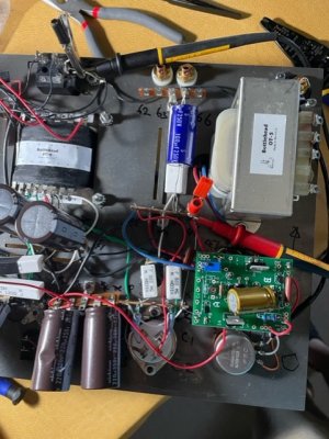

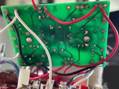

Can you post some more photos, ideally of the top and bottom of the PC board and the 9 pin socket wiring?  The output of the driver C4S will stay at 0V for a period of time before slowly ramping up, which is the intended operation of the soft-start circuitry.

Yes, I purchased this limited edition (the bronze color one) one out of Audiogon. It looks unused when I received it except for the capacitor dent as you mentioned. The "blackened" resistor is just a tape I stick on.
Attached the pictures requested.
I waited for 1 minute and the voltage still stayed at 0 volts.

Well the kit is built with stranded wire, and you may have some little strand poking out that's touching something it shouldn't.

You're missing a transistor on the B side of the PC board.

Thank you both. The missing transistor was it. It works now.
