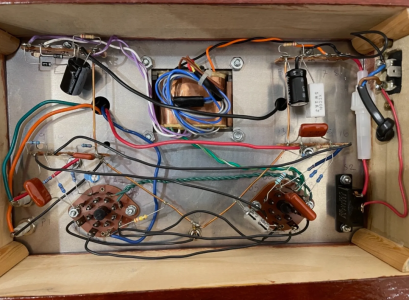

There may be some other changes that are worthwhile - we've learned a few things in the last 25 years! Which power transformer do you have? If you are not sure, a photo of the underside wiring will help.

Reply #7 on: July 13, 2022, 09:08:44 PM
Hope this helps

Reply #8 on: July 14, 2022, 04:08:46 AM
That's very tidy for that vintage of kit! You have the Deyoung power transformer.  I would definitely grab some fresh electrolytic caps.  Something like this would be lovely and very long lived:

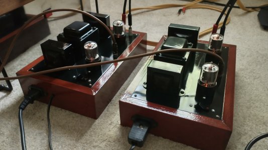

    • Posts: 7
Reply #11 on: July 15, 2022, 03:10:36 AM
A top view
