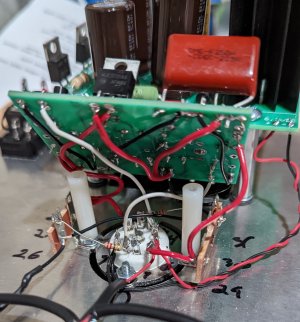

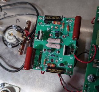

I am attaching pics of the top and bottom. I hope this helps!

231V is just fine.
