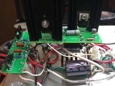

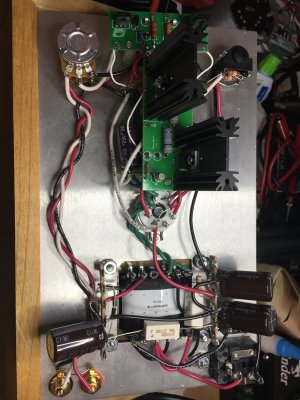

I have attached a couple build photos.  Terminal 2 goes on and off as I move wires around but I cannot seem to find the loose connection.  I guarantee that all of the components are in the right place and right orientation.  I am 71 and I have successfully built many electronic kits over the years.  After all, my Crack played beautifully before I installed the upgrade.  The more I work on it, the worse it seems to get.  I am frustrated with this and nervous about my upcoming surgery.  I ask a favor.  Could I please send my Crack to you for evaluation and repair?  If I shipped it to you priority tomorrow, 08/12, you should get it next Monday, 08/15.  If you were able to finish by 08/25 and shipped it back to me priority, I should have it by 08/29, right before my surgery.  That would give you 10 days to work on it and get it back to me before surgery.  I hope that you can help me here, or I am going to need to quickly order a different headphone amp for myself.  Thanks, Gary

From your photos it looks as though you have some level of short going on evidenced by the first and possibly second 270 ohm resistor in the power supply. Are the diodes on the left side of the terminal strip oriented and installed correctly? It's hard to tell from the photo.
I would revert the amp back to non speedball and use it that way until after your surgery at which point it might make a good project during your recovery period.
Take Pauls advice pull the tubes and measure the power supply voltages and make sure it has not been over heated to the point of non repair. somewhere between standard circuit and speedball you have a miss wire or faulty components.
