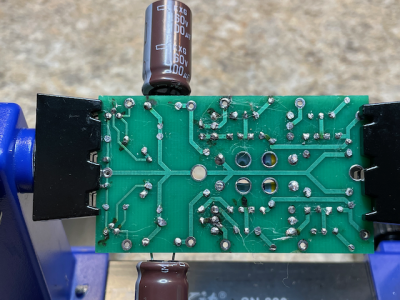

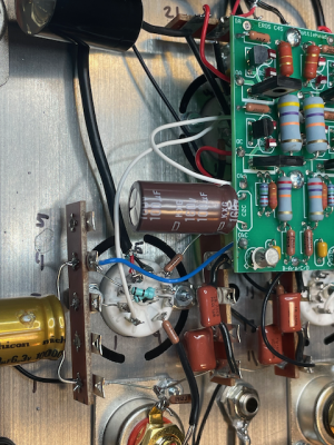

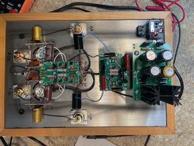

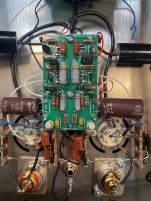

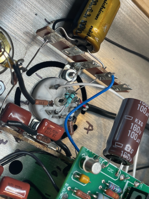

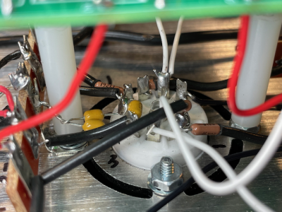

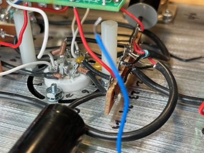

I’ve attached a couple of images. Let me know if another view would be helpful in diagnosing the problem.
Any thoughts on what I should inspect or measure next ?

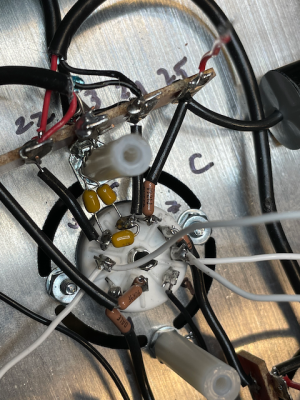

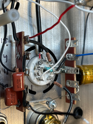

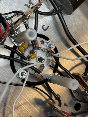

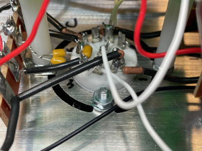

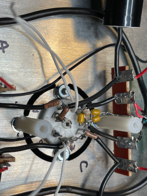

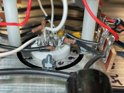

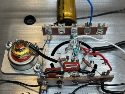

Can you unscrew the front C4S board and show me a shot of the wiring underneath it? (Of the C socket)
Offline nipsy
    • Posts: 25
Reply #2 on: August 23, 2022, 08:10:07 PM
How are these ?
    • Posts: 20249
Reply #3 on: August 24, 2022, 04:35:08 AM
The servo on one side is forcing the EF86 to draw no current.  This could happen from a flaky solder joint (perhaps on the forward C4S board), a miswire (which I don't see), or possibly a swapped pair of resistors (the brown Dale resistors are easily mixed up).

Reply #4 on: August 24, 2022, 08:46:23 AM
Hi Paul,
Thank you for your suggestions. I tested all the Dale resistors on the board and they all checked out as being correct.
I removed the CS4 board and reflowed the connections and neatened things up a bit. I touched up the solder on a couple of wire connections that looked a little on the weak side.
Resistance check was good. Voltage check gave me nearly identical results

    • Posts: 20249
Reply #5 on: August 24, 2022, 09:44:17 AM
If pins 3 and 4 touch on the EF86 socket on that side, problems can arise.  This is why the wire connections are supposed to be wrapped up and over the tube socket pins, not around the sides.  There's also an indent on the top of the socket terminal to keep the wires in place while soldering.  Still, this isn't likely to be your problem.
