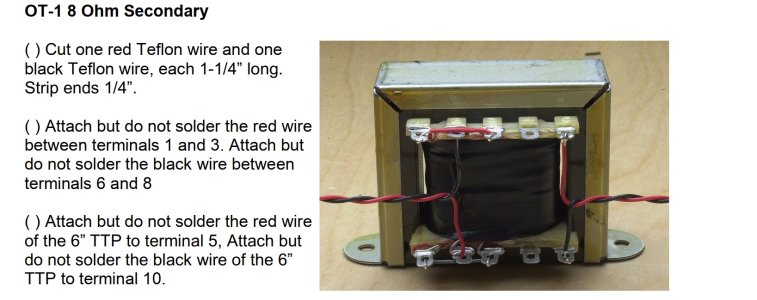

I recently purchased a pair of Paramount 300b amps. I am not sure how the output transformers are wired (4,8, or 16 ohms). Is there a manual or diagram available?

Yes, there is a short (one page) document on that transformer. I have attached it in PDF form. It shows the wiring for a 4-8-16 ohm switch using a 2-pole 3-throw switch.

This is the most likely configuration.
