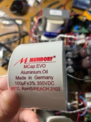

So I am about to change the "100uF 250V (Blue) - axial electrolytic Capacitor" with "Mundorf 100uf 350vdc Mcap EVO Oil"
It seems the original capacitor is directional according to the step in the manual
==>"Attach the lead that the arrows point to of a 100μF 250V axial electrolytic capacitor to 33U."
The new capacitor does not seem to be directional.
Did i get the right capacitor? I will attach a picture shortly.

    • Posts: 20302
Reply #4 on: November 05, 2022, 05:59:42 AM
Correct, the new capacitor is not directional.
Offline hpleung
    • Posts: 137
Reply #5 on: November 05, 2022, 06:58:12 AM
Thank you but sorry for the additional newbie question...but can i proceed with this replacement?
i.e. Can I replace a directional capacitor with a non-directional capacitor?
    • Posts: 20302
Reply #6 on: November 05, 2022, 07:44:10 AM
Yes, you just need to install it in place of the old one.
