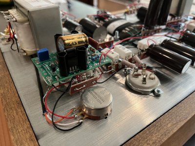

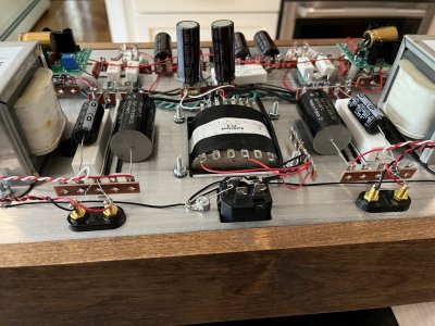

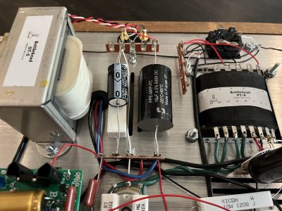

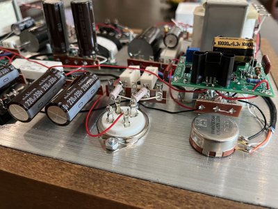

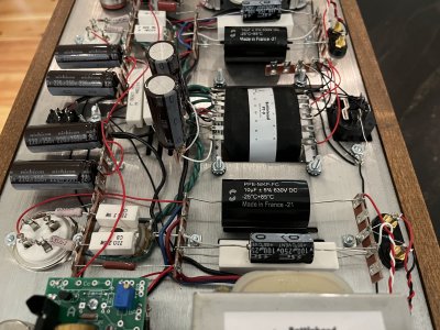

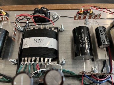

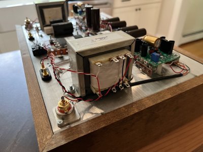

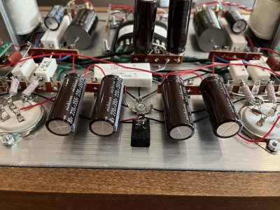

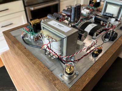

I recently complete my Kaiju kit and the power transformer is noticeably buzzing.  When the 300Bs are removed, the buzzing almost completely goes away and is barely audible.
I painted the chassis, transformer bell, and the chokes. I believe I had scraped away the paint from all relevant areas along the way. There is continuity between the unpainted underside of the transformer bell and the safety ground. Are there any notable places I should be triple checking that I have contact with the unpainted metal?
I've gone back through the manual step-by-step and have reflowed many of the solder joints. Everything appeared ok but after looking at it for so long I might need to take some time away from the kit before anything stands out. Given the symptoms, are there any specific areas I might focus in on?
I've attached a number of pictures in case anything stands out.
    • Posts: 20262
Reply #1 on: September 21, 2022, 06:35:39 AM
What are the DC voltages on each 4 pin socket with tubes installed?

    • Posts: 20262
Reply #3 on: September 21, 2022, 08:48:39 AM
I would tighten down the power transformer screws till they are very tight.
Offline dehringer
    • Posts: 31
Reply #4 on: September 21, 2022, 09:03:34 AM
I tightened down the power transformer screws very tight.  The screw with the 57-61 terminal strip was a bit difficult to tighten down while keeping the strip straight.  But the buzz remains.
