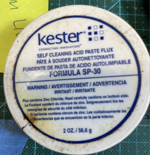

I used basic electronics solder for the Speedball. Not sure exactly what the percentages were but it's the same exact solder I used to assemble the stock Crack, and that's worked for over a year.
As for the flux, an image of the container has been attached to this post.
Reply #3 on: October 02, 2022, 03:40:18 PM
Acid paste flux is for plumbing, not for electronics.
Your Crack needs to be run (without the wood base obviously) for a full cycle in the dishwasher with hot water to get that cleaned off.  Please do not use any extra flux in the future.
