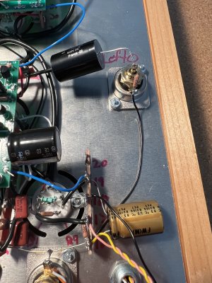

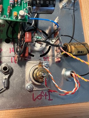

Here are some pics of the input installation. Other than that, I know the boards should be soldered well cuz I have reflowed all of them in my previous attempts to fix voltage.

You may have solder connecting the center of that RCA jack to the shell, and that would short that channel and not let anything through.
