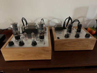

Here is a pic of the chassis, checked the wiring and all was OK, kept fiddling with and changing the RCA jacks and it just started working. Sounds amazing

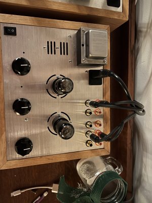

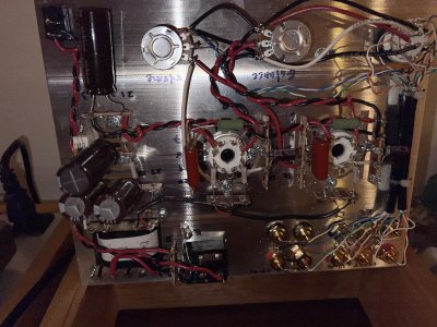

Reply #11 on: November 20, 2022, 03:34:07 PM
some more pics

The Moreplay manual does not mention it,but you might want to verify the 3 inputs and 2 outputs are working correctly. When I was done building mine, the middle input was not working because it was shorted from melting wire jackets while soldering. I was able to track it down and fix it.

Thank you, funny you mentioned that because one of the inputs (L1 & R1) dont work and I was confused and then I noticed the input selector only has 2 positions??? Did I mess up the install on the selector? Both output RCA's operate normally on the Moreplay.  Regarding the Stereomour, all the inputs function as they should. Thanks again, let me know what Im missing.
