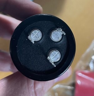

Hi,
Can I get some help to identify if this capacitor is directional or not? I would be using it in my Mainline. There are 3 feets, 2 + signs and 1 - sign. My understanding is, the 2 + signs are where I should connect the wires; the - sign is simply a feet for support.

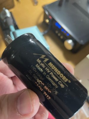

If you look at the designation on the body it tells you that this is two 100uF caps in a single case. They share a common low potential (negative) connection. So minus goes to ground and each positive terminal can go to a separate power supply HV node. Or the two positive terminals can be wired together to make a single 200uF cap.
In other words it wires pretty much like an electrolytic cap, minus to ground, plus to HV B+. Don't wire it the way you propose!

Wao...Good thing i checked. Thank you very much.

Just so you know, the power supply caps in the Mainline are not in the signal path, so there's not a substantial reason to mess with different parts there.  If you are planning to use two of those and replace the doubler caps, you'll want to double check that the ripple current rating on those caps is sufficient for the job (don't always assume something like that purely based on size, I've been fooled before!).
