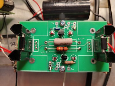

I completed the mainline, but unfortunately failed the final voltage test. The power transformer, power supply, and resistance tests all passed with no problems. In addition to the incorrect values for the voltage test, the pair of LEDs on the B sides of the C4S boards are not illuminating. I double checked and they are oriented correctly.
I went back over the instructions from the power supply test onwards and could not find any obvious miswirings or bad joints. Any ideas on what could be going wrong here?

« Reply #1 on: January 17, 2023, 02:29:04 PM »
This is very likely to be solder joint problems based on the non-existent Breg voltages. The MJE571A transistors in particular need a fair amount of heat to solder properly.

I may have found the issue, but could still use some help.
I reviewed the instructions to check the wiring and also resistance checked every non-colorcoded resistor manually using my voltmeter. I found that the C4S board R1 resistors on the A sides of the boards have values of 37.4 killoohms while the manual says a 37.4 ohm resistor should be used. The resistor is navy blue and labeled 37.4 K1% 2213. I assumed that I mixed up two resistors, but all the other resistors in the build appeared to be correct and I do not see anything in the parts list for a 37.5 killoohm resistor.
Could this resistor explain the failed voltage test and unilluminated LEDs? Do you think this could have been a packaging error or am I still missing where this resistor should be?

« Reply #7 on: January 18, 2023, 06:55:36 AM »
Well that would have taken a long, long time to find!  I let Eileen know that possibly we got sent (or ordered) the wrong part.  This kind of stuff happens from time to time and we can just send out some replacement resistors.  You can actually just solder the correct resistor across that one and thing will still work properly.
