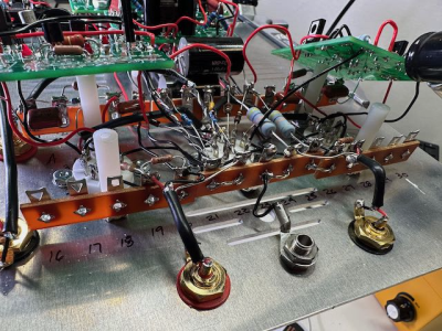

Well, 7 years later I finally got around to building my Eros.  Thus this question relates to Rev 5.19.09 according to the manual cover.
I've finished assembly and carefully inspected all joints and connections.  All looks fine, I double-checked each of the connection points as assembling and also as I finished every second page since I don't have anyone else that can look at it for me.
I'm now running through the resistance levels.  Here is what I am getting on the terminal strips.

Slightly high resistances make one suspicious of a possible soldering issue (maybe on the ground buss), so it's worth looking at all the joints where black wires connect to be sure they are all solid.

Thanks, I looked over and checked the conductivity between each connector for the bus bar.  Nothing out of the ordinary.  I will try reflowing the solder on each connection on the Ground bus bar.

I've checked each connection and reflowed the solder on each black wire connection, then pulled with the needlenose on each wire to see if i spot any weak connections or where I may have nicked a wire by accident.  All seems fine.  Also double checked the values of the resistors running between the but bar and the other terminals.

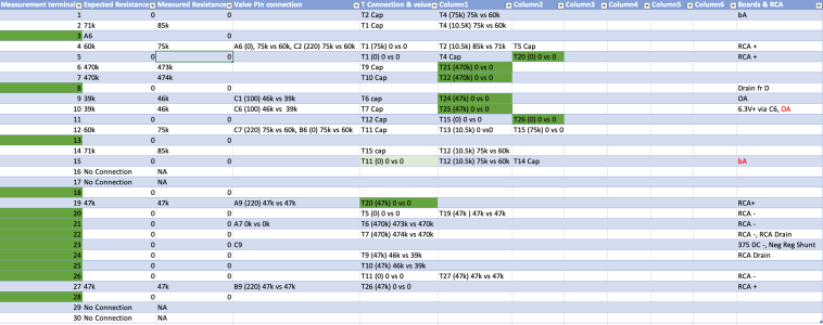

Thank you for the suggestion.  I did a test against a wire wound resistor and I have two different meters.   The test was spot on and both meters are reporting the same.  In addition, other pins are ok, Such as Terminals 27 and 19 are to be 47k and both of those are spot on.
I've been creating a spreadsheet to backtrack every connection (also to double check that nothing is connected in the wrong spot, but I've already done that step by step so I don't think so) and I notice on T4, T9, 10 and 12 the values all correspond to a single resistor, T4 75k  is a match to the resistor between T4 and T1 (75K), T9 at 46k is close to the 47K  between T9 and T24, T10 at 46k is close to the resistor of 47k between R10 and T25, and T12 at 75K  is close to the 75k between T12 and T15.
T2 and T14 I have values of 85k, but I notice both of these appear to put 10.5k resistors in series with Terminals T4 and T12 both of which of course have readings of 75k.  So I think I can rule out anything at T2 and T14 as the culprits.

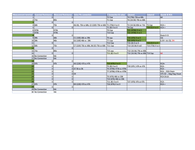

I've tried attaching my spreadsheet below
Any other insights would be welcome.  Thanks for any help
I spotted an error in the spreadsheet, on T12, it shows as connecting a 10.5K resistor to T13, which is wrong, it is actually T14.  I wired it correctly but the spreadsheet is wrong.
