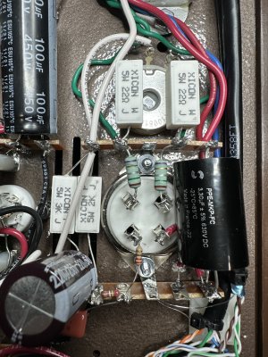

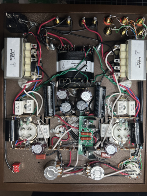

I have recently assembled the Streomour II (painted wood and metal) and unfortunately, I am experiencing issues with the unit not powering up. Despite attempting to troubleshoot the issue using the resistance measurements provided in the manual (pages 63-64), my readings were inaccurate and incorrect.
As I am not experienced in soldering and have never attempted it before, I am unsure whether the problem lies in my soldering technique, such as using too much lead or making incorrect joints, or whether there is another underlying issue. I am reaching out to all of you for your expertise and guidance in this matter.

Looking at your first picture I see a problem where at the power trans the diodes that are twisted together are not soldered, that's gonna cause problems. Also some of the solder joints look ok but many need more heat so they dont look crusty.

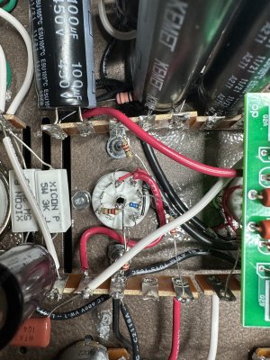

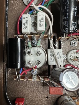

You have a backwards 100uf/450V cap.
You have a backwards UF4007 diode.
The soldering video will be very helpful, as more heat will be required to get good joints in a lot of places there.
