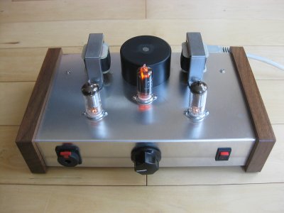

Reply #3 on: March 26, 2023, 11:36:50 PM
One of my favorite builds was converting my Quickie into a Hammond chassis, i call it the BabyBottle.   ....i got a bit carried away and it ended up as an AC powered headphone amplifier, but its still a Quickie, sort of :)
