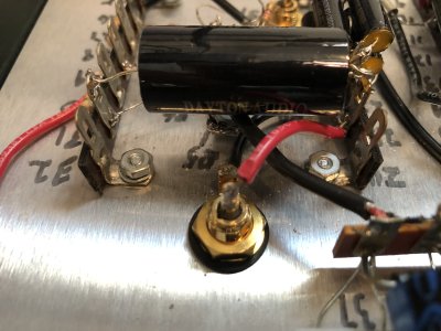

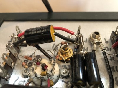

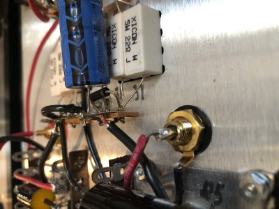

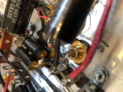

Tried to clean up these areas the best I could. I'm still getting a very weak signal from the left (black) channel
See attached pictures. I'm not seeing solder to remove from base anymore. And the side that works looks similar. Do I need to remove more?
If so could you show pictures of what looks correct, and tools you would recommend to scrape away and remove solder in areas like this?
thanks
Larry Southern

In the first photo you posted, the wire going through pin 5 on the tube socket is bent sideways.  If that touches pin 6, you'll get smoke.  I would trim that ASAP.
If you have solder shorting an RCA jack, you will not be able to measure the 47K or 475K resistor that spans the jack with your meter (it will measure closer to 0 ohms).  So you can put one probe on the center pin and the other probe on the shell and check those resistances.
I also see plenty of leads that aren't bent up and around terminals, and lots of solder joints that need more heat to flow out properly.
« Last Edit: April 03, 2023, 07:00:19 AM by Paul Birkeland »

Trying to understand- there are no resistors as you can see on the output
What resistances should I be measuring?
Are there specific places I should be confirming connections?
I did trim the output, you can see from the photos I posted.
    • Posts: 20217
Reply #7 on: April 03, 2023, 08:08:03 AM
Measure the DC resistance across the output jacks.  It should be about 475K.
