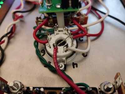

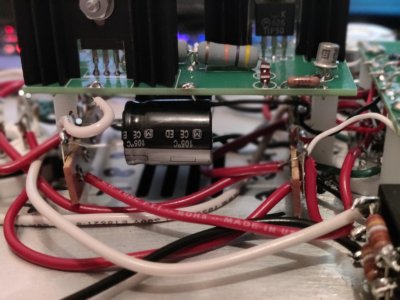

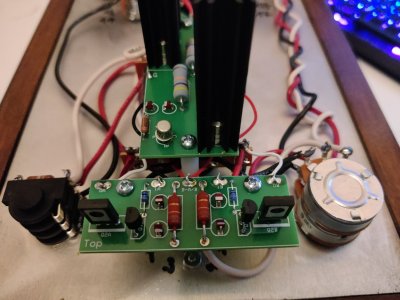

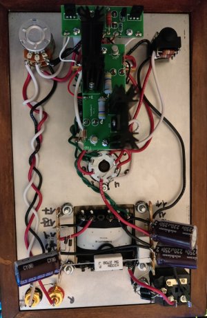

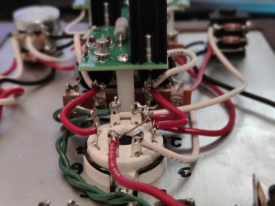

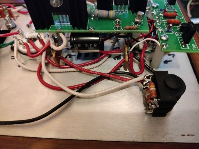

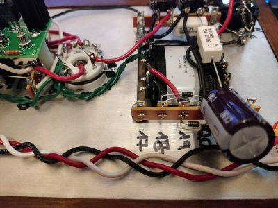

I finished building my crack a few weeks ago and so far I'm pretty happy with it.
Today I installed the Speedball upgrade.
Unfortunately I don't get any sound now. All LED's light up and the tubes are also heating up.
There is a distinct crack/pop a few seconds after turning the amp on. But no loud buzzing or humming and it is silent otherwise.
My voltage readings:
OA      114,7V
OB      110,2V
G        0V
B+      190V
OA      74,7V
IA       190V
B-A/B  0V
IB       190V
OB      84V
The mains voltage is 230V.
Any help is appreciated.

    • Posts: 20260
Reply #3 on: April 16, 2023, 06:37:39 AM
Could I see some shots of the headphone jack and volume pot specifically?
The issue you're hunting down is very likely to be something that was present in the initial build and was knocked loose when installing the Speedball.
Offline vinnie
    • Posts: 3
Reply #4 on: April 16, 2023, 10:02:21 AM
No need. I found the issue.  :D
I checked all solder connection before and they seemed fine.
I removed the screws to the large circuit board to get a better view and maybe find some loose wires.
Only then I noticed that the wire connecting 9U to OA was broken somehow.
I rewired it and it did the trick.
Thanks :)
