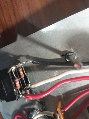

I removed the Speedball kit, and am reinstalling the standard model coils.
But I can't resolder the 22.1k resistance because the wire was cut very close to the resistance.
In my city I only found the resistance of 22k, 1W, 10% tolerance.
The colors are (red, red, orange and gold).
My question is whether this resistance is a good substitute.
My other question is in which position should I solder it in the circuit.
Thanks.
    • Posts: 20348
Reply #1 on: May 15, 2023, 04:20:12 AM
That resistor will work to replace what we provided.  I'm not sure about your other question, as you would simply put them back where the manual instructs you to.

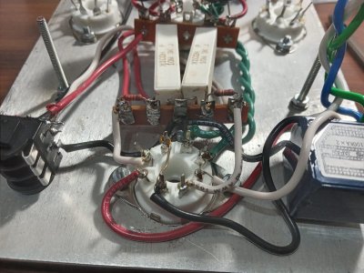

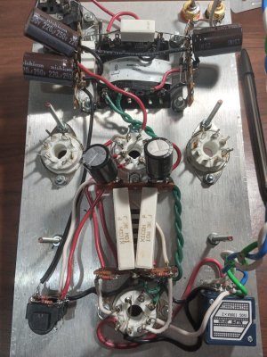

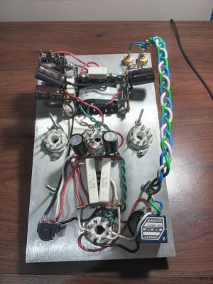

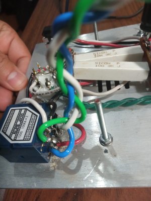

I would like to add to my previous comment the following:
With a little more listening time, I realized that saturation affects all frequency ranges when the volume is increased, that is, the sound distorts at higher volumes.
I installed a 6sn7 socket in place of the traditional 12au7.
Wiring from the volume pot to the RCA jacks is 1.5mm stiff wire. (I had to adapt, because I'm going to install two 8-pin sockets to use 6j5g and I had to lengthen the wiring that goes from the volume pot to the RCA connectors, because I'm going to install two film output caps and I'm going to run the wiring over the caps). The thread that comes with the Kit was insufficient for these changes and in my country I can't find similar thread.
I'll post some pictures of the assembly.

Why do you have pins 3 and 6 grounded on your driver socket?
Offline shimacm
    • Posts: 12
Reply #11 on: May 19, 2023, 12:41:21 AM
If I shouldn't connect pins 3 and 6 to ground, how should I connect them then?
In socket 12ua7, there is a central pin to which the ground is connected, and from it, LEDs are connected to pins 3 and 8.
But socket 6sn7 does not have this central pin.
How to proceed then?
Offline Tom-s
    • Posts: 505
Reply #12 on: May 19, 2023, 02:15:04 AM
Bias the tube using the leds and it will function. Same as 12AU7 Crack.

Reply #14 on: May 19, 2023, 03:42:41 AM
It worked!!!! The magic happened again!!! Thank you for your help!!!
