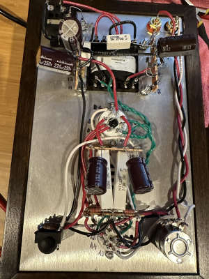

Hi folks - I'm at the last stage, glow test and resistance checks all passed.
Failing voltage test however.  Measurements:
T1 - 145
T2 - 160
T3 - 0
T4 - 160
T5 - 145
T6 - 0
T7 - 145
T8 - 0
T9 - 145
T10 - 0
Picture attached.
Appreciate any tips - thank you!
    • Posts: 20260
Reply #1 on: May 23, 2023, 09:26:42 AM
I would recommend watching this:
I see a lot of wires and components with no mechanical connections and a lot of solder joints that aren't likely to work well.  It's quite possible that remedying these issues will leave you with a working amp.

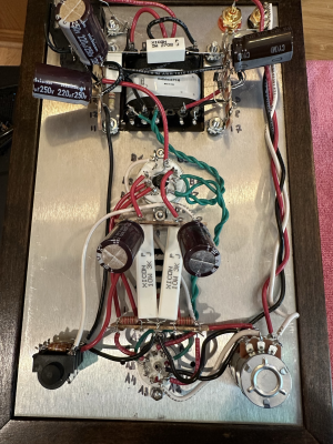

Well, I watched the video (very helpful!), took a pass through the joints and tried to re-do things best I could.
Unfortunately, so far it has not made any difference - getting same voltages.
Resistance checks fine, tubes glow, but still no LED and same bad voltages :(
Attaching new picture.
Any other thoughts or suggestions would be appreciated!
    • Posts: 20260
Reply #5 on: May 24, 2023, 06:33:58 PM
Can you very carefully take a DC voltage measurement at A3?
Offline sano
    • Posts: 5
Reply #6 on: May 24, 2023, 06:47:27 PM
Sure... a bit weird.. it started around 13V, then slowly rose in 0.1V increments... seems to stabilize around 18V after a minute or so.
    • Posts: 20260
Reply #7 on: May 24, 2023, 06:52:41 PM
That is typical for an open LED.  I would order up some replacements and use a bit less heat when soldering them.
(There is also the possibility that the jumper between upper and lower levels on the volume pot where the black wires connect is missing, so double check this as well)
Offline sano
    • Posts: 5
Reply #8 on: May 24, 2023, 07:06:37 PM
Thank you, will try the replacement LEDs and report back.
(The volume pot jumper seems ok)
