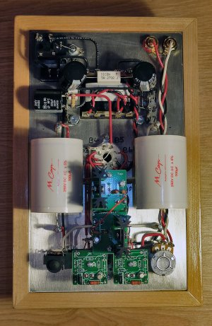

Having been using my Crack for many years now and still really enjoying it, I've decided to relook at fitting resistors to stop the volume getting too high too quickly with my Bayer Dynamic T90 headphones. I held off all this time just in case I tried other can's. I have two questions.
In the FAQ it says fit a 75K resister on both channel inputs to volume pot, but I'm unsure of the 33K position or amount.
As these are fitted into the signal path, is there a recommended make which would give the best sound quality.

At the bottom of the first post on the FAQ, there's a picture of a pot with the four resistors added:
https://forum.bottlehead.com/index.php?topic=4295.0

Hi thanks for the reply, yep I saw the photo. Just not clear on the 33k position, I can only see one but I guess the other one matches the top one on other channel.
    • Posts: 20260
Reply #3 on: May 28, 2023, 06:57:01 AM
Yes, the other one goes on the bottom row of lugs on the pot just like the one up top.

I understand the 75k resister job in reducing signal but what is the job of the 33k.  ???
    • Posts: 20260
Reply #5 on: May 28, 2023, 08:03:02 AM
Here's a helpful reference:
https://goldpt.com/preattenuation.html
The second resistor set keeps the input impedance of the Crack around 100K and increases the amount of attenuation.
