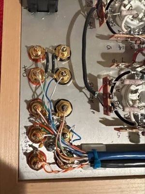

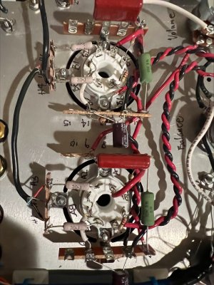

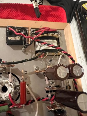

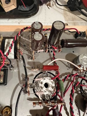

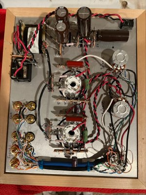

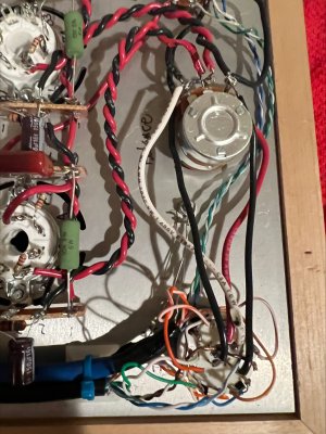

Some pics....

Reply #8 on: August 09, 2023, 05:58:36 PM
If the wires going from power transformer terminals 6 and 7 touch each other, they will cause the transformer to get hot and overheat it.
What I would suggest is to actually remove the shielded twisted pairs of wires leaving power transformer terminals 6 and 7, then redo the power transformer AC voltage checks in the manual and let us know what you find.

Reply #13 on: August 10, 2023, 10:39:37 AM
You will, at minimum, need a new power transformer.  I suspect the shielded twisted pair of wiring leaving the power transformer was shorting out that winding, and that toasted your power transformer.
When you order a replacement power transformer, I would also ask for a few feet of STP wire, then redo that wiring and make it look at close to what's in the manual as possible.
