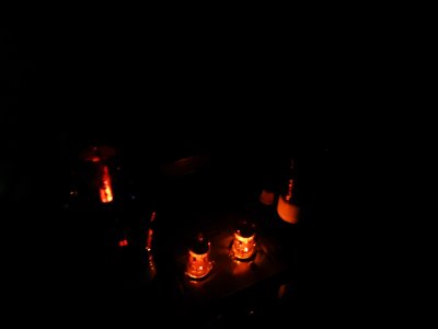

Over time, I found that left channel was not at the same level as the right channel. The problem was more significant after 3 hours of listening.
I exchange the tube left-right, and the problem follows the defect tubes. Also, the elements of the tubes that has the problem is not as bright as the tube that works fine. The level could be fine when I turn on the Stereomour II, but after sometimes, the level drop now by 50%.
Is there any tests that I could do to confirm the problem with the tube?

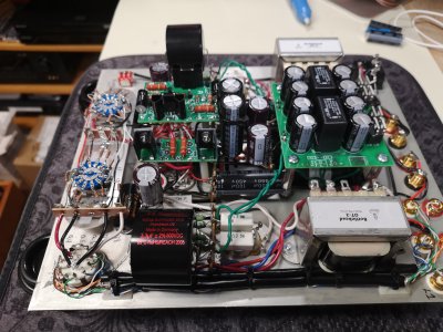

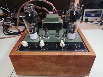

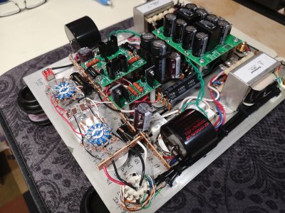

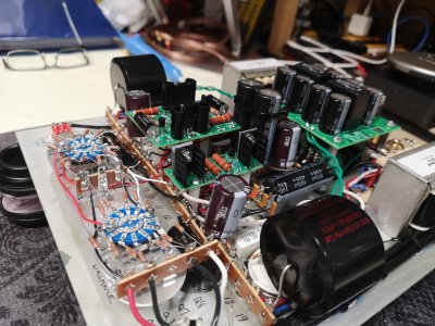

I include photos of the inside of the Stereomour II.
This is the result of the all of the verifications.

This morning, I turned on the amplifier and no sound from the left, the tube with the problem. I swapped again and the problem follows the tube. Now, the tube with the problem is completely dead, no light and no sound.

You would want to post the voltages at pins 1, 2, and 4 on each 4 pin socket once the difference in channels appears.

I followed Paul's advice and redid the contacts on the fatter pins of the defective 2A3 tube. I noticed that one of the contacts had hardly any solder. Before redoing the welds, I use the multimeter and compare the good tube with the bad one and there was no continuity between the fatter pins. Since the quality of the welds meant that the contact was not optimal, I decided to redo them for the 4 pins of the defective tube. I tested the tube and it worked perfectly. Based on this experience, I decided to redo the welds on the functional tube. The contacts were better, but there was still very little solder.
Now both tubes are illuminated with the same intensity. Also, after listening for one hour, I think the sound is greatly improve. To test the proper functioning of the tubes, I will let the amplifier run for the next 24 hours. But for now, I think the problem is solved.
