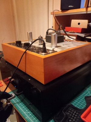

They are the same, I had the same problem with my C2A and Mainline. I dissasembled one to see if I could use a lesser tension spring but no go. I do not see the need for the locking jack. So I took a neutrik d series rca that I have in stock, removed the rca and used s step drill to enlarge the hole and ordered a Neutrik headphone jack and it works fine. No need to have King Kong on speed dial to come over and press the button.  Mouser has the parts.

That was pretty cool what you did, Lee..
I was thinking of taking the TRS jack out completely from the C2A and putting in the balanced one instead.. Let's see..
