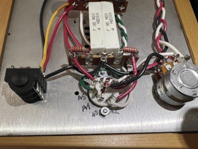

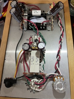

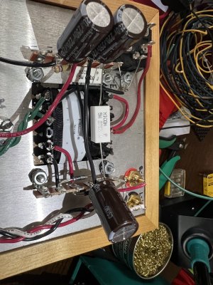

I finished up the Crack last night and did resistance and voltage checks - all good.  I fired it up with audio today and it makes good sound but with an underlying hum. 60hz, of course, doesn't vary with the volume, present with or without source attached and dies as soon as power is cut.
Is the heater string perhaps jumping onto the output.  I will attempt to add pics in following posts - board has not let me so far.

12 and 14 should be connected with a black wire, I don't see yours???
Hopefully the stranded wire you used wasn't provided by us.  I would strongly suggest removing it and putting in what we provided if possible.
Offline hokenpoke
    • Posts: 9
Reply #10 on: September 26, 2023, 03:25:49 PM
12 and 14 are tied together - just hidden under the filter caps.
I replaced the heater string between the rectifier with solid core and flew it up and away from the rest of the signal path. After this the buzz got worse so I poked around with a chopstick and found the problem - an incomplete solder joint on the output jack sleeve terminal.
Now there is no resting state hum when the tubes are not warmed up.  When the tubes come up, there is a quiet hum which does vary with the volume pot. I assume this is from the heater string so I will see if there is an configuration that cuts this down some.

Making the twisted pair heater wiring lay close to the chassis panel (ground plane) is the best setup to minimize radiated electrical field from the twisted pair. Hum that varies with the volume knob position is not coming from the heaters, it is coming from the input, ahead of the volume control.
